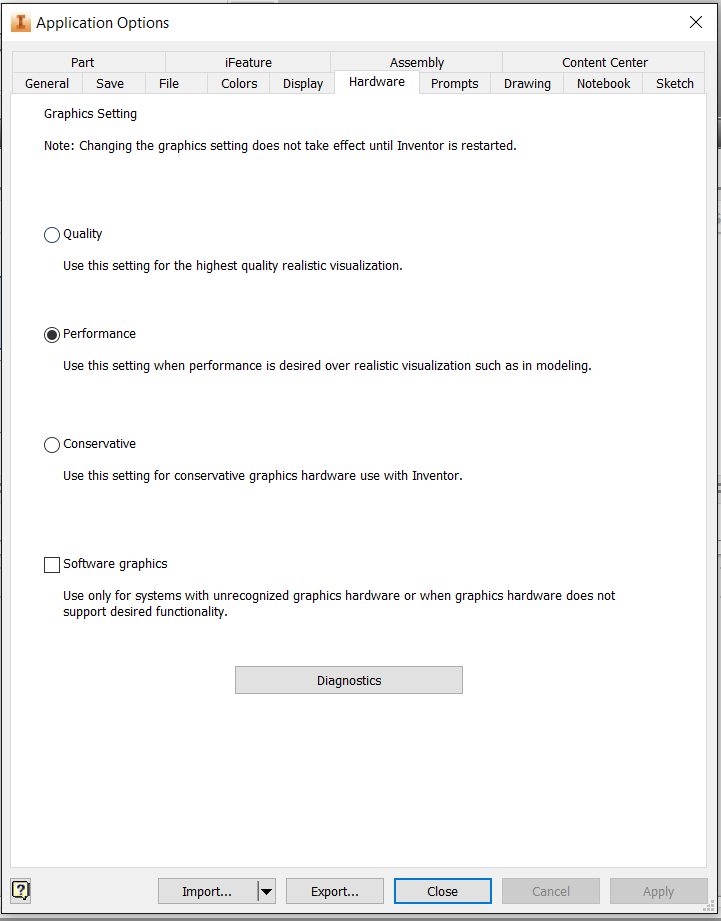

What is your hardware setting under application options?
Also are you up to date on your video card drivers?
As for the rendering, depending on how and what you're rendering it could take a lot time, but it also lets you keep rendering til satisfied ..
I've done 5 reiterations and 400 of a image in Studio, ..  what are you using for settings?  4000 x 4000 ?

this is the setting I was talking about application options .... ALso is your Inventor fully up to date with Patches and updates
is it rendering or Rendering Animation?
Mike Davis
Message 5 of 31
@mdavis22569   My hardware settings is on Quality ..
 15s of rendering animation
Message 6 of 31

mdavis22569
change it to performance ...and see if you're ok with that quality. I do Hi-Res images ...and I'm on performance without any issues

dgorsman
A couple of points:
  • Inventor doesn't use the video card for rendering, as in creating images or movies.  The process is strictly CPU based so no amount of video card tweaking will help.
  • 4.5 hourse for 15 seconds of animation is about right.  Consider that 15 seconds run-time x 24 frames per second is 360 frames; 1 minute render time for each frame is 360 minutes, or 6 hours.
  • The larger the image (in pixels, not DPI) the longer it will take to render each frame.  The higher the quality the longer it will take.  Its not at all unusual for a large, high-quality image to take several hours to render.
