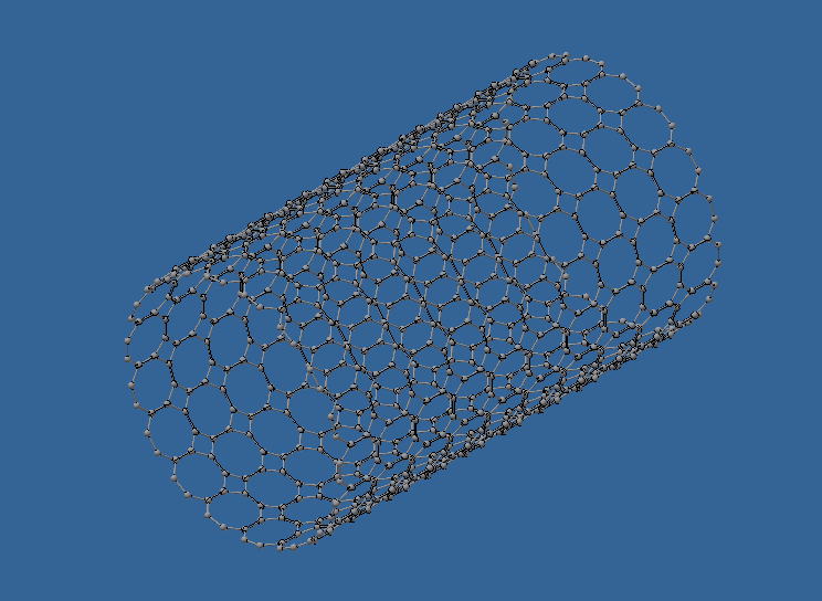

Hello all,
I was wondering if anyone knew how I would go about making a carbon nanotube in Autodesk Inventor 2016. I'm not really familar with this type of software, I have used Google Sketchup before, but only briefly. If anyone could point me in the right direction, it would be greatly appreciated.  I attached some pictures of carbon nanotubes below.

1. Make a sketch of a hexagon. Make a sphere on one of the corners.
2. Make a sketch across a hexagonal axis, make a sketch perpindicular to that plane across the middle of the hexagon leg. Extrude a cylinder to connect it
3. Pattern the spehere/cylinder around the axis of the hexagon.
4. Pattern your nanotubes lengthwise down the overall cylindrical structure
5. Pattern the nanotubes around the cylindrical axis.

Here is 1 way of doing it, depending on what your needs are.

Ok, so I have a problem, I looked at the way MechMachineMan went about creating the nanotube, but it won't let me select anything to pattern. I have a .iam file of a single graphene hexagonal unit already. So, then I went and created a .ipt file of a cylinder. Next, I created another assembly file and placed both components into the modeling area. For some reason when I go to circular pattern it will let me select the axis, but not the features to pattern. The actual hexagonal model, I made by creating a cylinder and then I attached a sphere to the end of it and saved it as an ipt file. Then I went in assembly, and copied it over 6 times until it shaped into a hexagon. What exactly am I doing wrong here and why won't it let me press OK?
Message 14 of 30
JDMather
You pattern features in a part.
You pattern components in an assembly.
Attach your assembly here.

kasperwuyts
Just a reminder. The graphene hexagon in a nanotube isn't a 2D hexagon. It's slightly crooked. So starting of by creating your basic 2D hexagon won't get you where you want.

kasperwuyts
The first thing that you need to know is the science of nanotubes themselves. Do the angles between all the covalent bonds remain identical even if they aren't located in the same 2d plane anymore? Does the graphene get stretched out somewhat in the direction of the tube itself?
Once you know exactly how your basic carbon hexagon works, it's a simple matter of creating half a hexagon (three atoms, three bonds) and patterning it.

Ok, so some one showed me how a simpler way to create the hexagons and the graphene sheets as a part file rather than in an assembly and I've run into another problem. Im't to revolve the other parts so that the look like the one that is already revloved around, but it gves me this error. (See picture below)
It worked when he did it this afternoon, so I'm not sure what I'm doing wrong.
Message 19 of 30
