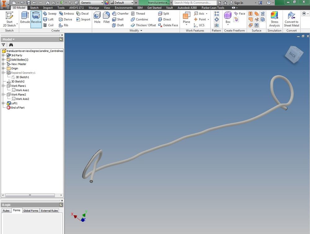

Hello everyone,
I have got two files with IGS & IGES formats,
The file includes the centreline of a tube which has been extracted from an an X-Ray file of the actual tube.
The problem is that, since the tube centreline is not in a single plane, it is divided into lots of small pieces of lines. My plan is to use a smooth line and sweep a circle along it to replicate the tube.
The problem is that I cannot find a way to smoothen the line in inventor. I even tried to project the centreline on a plane but it did really work!!
So, could someone please kindly help me on this?
Best,
Ali

Hi Alimosayyebi
I made a 3D sketch and cherry picked a few points off the imported 3D sketch using a spline.
I don't know how accurate / smooth the loft need be (I tryed sweep but no joy) so re-make
the centre line 3D sketch if not smooth enough.

If you are attempting to reduce the design to a simplified form - you should be able to get any desired path for a Sweep by following the general instructions in the attached document.
Message 6 of 9
blandb
Not sure if you found a solution, but I have attached a swept tube along your supplied path. Please see attached.
I do agree with @JDMather, what is the purpose and simplification would be a good idea.

Hello @Anonymous
thanks for the file,
this seems to be something similar to what I am looking for,
Still through, I would need to sweep it rather than using loft! because the tube is supposed to be a pipe rather than a solid tube, similar to the attached photo. Also, I will be putting later holes on the wall, shown in the image, so I believe would be a better option!
Thanks very much @JDMather for the link, I am now looking into it to find the closest route to the actual centre line! The centre line is extracted from the x-ray of a pipe so it's better to use, ideally the closest path without nodes and breaks.
Thanks very much @blandb for the file, the problem with this is the breakages in the nodes! so I believe @Anonymous file is a better to go for now. However, still the problem of creating a pipe exists.
Best,
Ali

@Anonymous wrote:
...Still through, I would need to sweep it rather than using loft! because the tube is supposed to be a pipe rather than a solid
Shell
