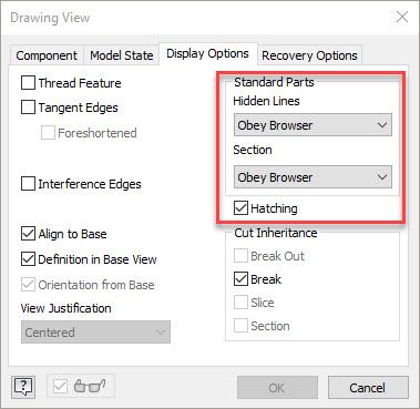

Hi!
Usually the Inventor-drawing recognizes (in a section of an assembly) a ContentCenter-Part and does no section (no hatch).
After "Refresh standard components" with the designated Inventor command this "automatism" is gone.
We have a customized CC (with our partnumbers and some other information in the customproperties), and only edited some customproperties. (no model geometry).
Is this a known issue?
Did we do something wrong?
How to fix this issue?
I attached the files for testing.

It's really a myth to me why and how inventor decides to section these standard parts. I think this is a bug and should be reported to Autodesk.
@viktor.bednarik, @johnsonshiue
There is a workaround, it's a little complicated:
  1. Save a member of the standard part As Custom instead of As Standard.
  2. Open the part, unselect the option "Paticipate in Assembly and Drawing Sections" in the Modeling tab of Document Settings, save.
  3. Select the family in Content Center Editor, right click and select "Replace Family Template" and select the part as replace.

Hi! I am an engineer, not a politician. I am trying to help here. Let's focus on the issue. For any given component, Inventor determines if it participates in sectioning based on an option in Document Setting. Go to Tools -> Document Settings -> Modeling. You will see the check box "Participate in Assembly and Drawing Section."
I checked the two parts you attached here. The option is checked. This is why I said the behavior was designed. Purely based on the files, I cannot tell when and why the option is checked. It is possible when the part was published, the option was already checked (on by default in Standard.ipt). Or, it was checked afterwards.
If you don't want the option checked, there are two ways to do that. You can find the original source iPart and make sure option is unchecked. Then re-publish it to Content Center. Or, you can use the template replacement workflow in the following page.

I think I may have found the behavioral pattern now. The option "Participate in Assembly and Drawing Section" option has an interesting behavioral model.
When the option is checked, the followings will happen in the drawing.
1) The part (regardless of CC or not) will be sectioned in a part drawing view by default. You will need to change the Section Participation option in the drawing manually.
2) If the part is in an assembly, the assembly drawing view will honor the browser default (Obey Browser). All CC parts are not sectioned by default regardless of the option.
When the option is unchecked, the followings will happen in the drawing.
1) Above #1 behavior applies here too.
2) If the part is in an assembly, the assembly drawing view will honor the browser default and exclude the part from section view. Changing the option will trigger a change in Section Participation in the drawing.
In the assembly, the virtual section view behavior is much more straight forward. All CC parts are excluded from sectioning regardless of the option. Non-CC parts will depend on the option.
In the part itself, the virtual section view behavior totally depends on the option. When it is on, it can be sectioned and vice versa.
I have to say it is indeed confusing since the behaviors can vary in different document types and different sectioning operations. I hope my explanation makes sense and it is consistent with what you are seeing.

The option behavior is actually logical and reasonable, albeit a little confusing sometimes. What caused the initial confusion of OP and this whole thread is the Refresh behavior of the Content Center. What I am talking about is this:
As I said above, the default behavior of CC parts is NEVER sectioned in assembly or assembly drawing, however, if the CC parts are REFRESHED, then the CC parts will be sectioned in assembly or drawing.
That screw from OP is apparently a refreshed CC part, so it gets sectioned and cause more confusion to @Mark.Lancaster.
The steps to reproduce this issue:
1. Place a CC part As Standard from a customized CC library.
2. Check the assembly and drawing to confirm it's not sectioned.
3. Edit the family table of the CC part in CC editor, Add a new column to the table, and map the column to some iProperty.
4. In the assembly containing the old CC part with virtual section turning on, click the Refresh command, refresh the CC part.
5. Now check the result, the refreshed CC part is sectioned.
6. Place a new member of the family, the new part is not sectioned.
