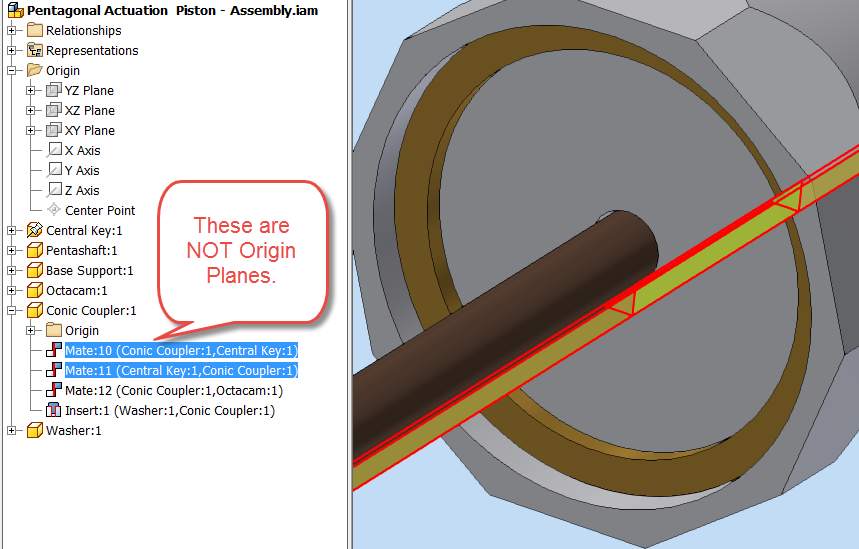

The correct answer is No, I did not use the planes, I used the sides of the key and keyway.
Message 25 of 42
Planes were selected from model widow, I don’t know why it is wrong?
Message 26 of 42
JDMather
No.
Planes WERE NOT selected for your Mate 10 and Mate 11.
You selected the sides of the key and keyway.
Inventor doesn't lie.
Your error occurs before the Washer part.
The washer has no keyway.
All of my questions have referred to KEY and KEYWAY.
(See Post #15.)

Problem was I was talking about the WASHER you were talking about the CONIC COUPLER. Yes I used keyway to constrain CONIC COUPLER. Which was wrong because width of the keyway was not identical to key and it created many subsequent problems.
Once again importance of using the Born Technique was understood.
Now I can understand the problem.
Thank you very much for your explanation.
