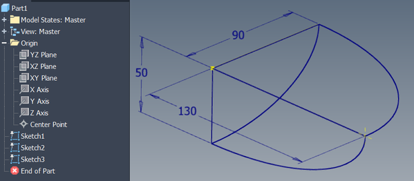

I am trying to make triaxial Ellpsoid kind of shape using inventor and  I am having difficulties. I am trying to make something like shown in image below.
but I have one line, lets say blue plane in above image. That line I need it to be straight and red line would be quadratic. Look at attached image.
Using lofted gives me straight line between two curves at the base. (see lofted image)
Is there any way to do it in circular pattern?

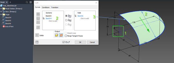

I 'm not sending you the file, because i dont have 2014 version, only 2017 and therefore you will be unable to open it, but check the video and try to replicate it.
The trick is:
Transform in construction every geometry that you will not use as profile.
Do it in surface and turn it in solid.
CCarreiras

CCarreiras
Hi!
1 - Edit the sketches and Transform the geometry that you don't need as construction geometry.
2- select both arcs
3-Add the rail
Boa sorte!
