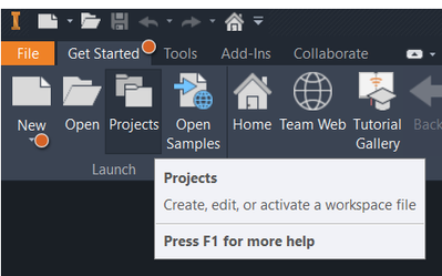

STEP 1 Create a new project folder
Within this new project folder create a New Project and make sure it is active.
Message 32 of 115

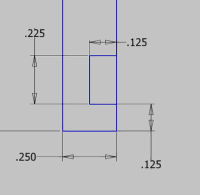

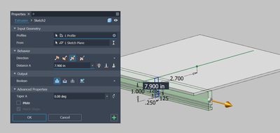

Message 34 of 115
JDMather
Go to the Right Side view and start a new sketch on the YZ plane.
Project Geometry the bottom line of the extruded rectangle from previous step.
Sketch two  2-Point rectangles as shown...
Dimension as shown below (remember the = sides constraint tip).
Extrude the Sketch2...
Mirror the extrusion to the other side ...
Message 35 of 115
JDMather
We need to make an edit.
Right click on Sketch2 and select Edit Sketch.
Double click on the .125 dimension and change to .225 as shown..
Click on whichever line you made = and delete the = constraint.
Add the .125 dimension shown...
Do you see how we edited this feature more easily than you did in your original file?
