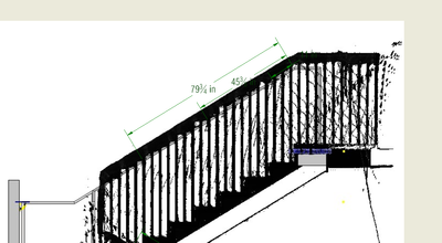

paulZKN98
A few years later and this question never found it's solution.  I often run into this as well.  Below is an example of a image inserted over a dimensioned view.  I need to drag my dims out of the way, but in doing so it will move the graphic instead.   There is no way to lock the graphic in place.
The only success I have had is to hover over a leader/dimension/text item > Select Other > select your item and manipulate. This prevents an accidental selection/move of the graphic.  I hope this is helpful.
