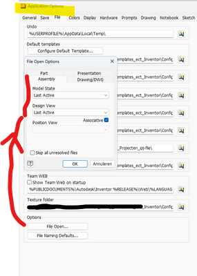

robbeRtek
there are also some open options in the application options.
it could be that they are used instead...

johnsonshiue
Hi! I believe there is a regression in 2025. It used to work fine indeed. Please take a look at the following thread. Feel free to contact Autodesk Product Support to escalate a fix.
https://forums.autodesk.com/t5/inventor-forum/application-options-file-open-setting-being-overridden...https://forums.autodesk.com/t5/inventor-forum/application-options-file-open-setting-being-overridden...
Many thanks!
