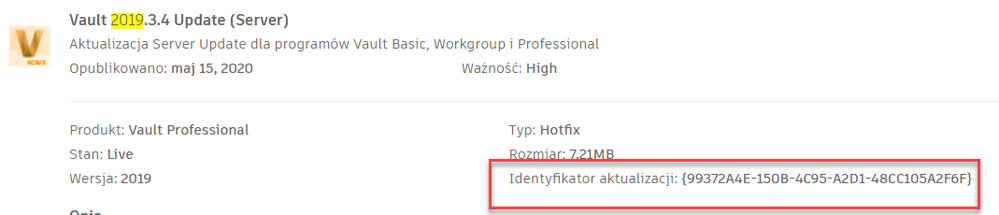

In my company we have various product configurations, and total amount of users is around 60.
I use to update all my Autodesk products frequently and always keep it up to date.
The natural proces is installation of products >>patching >>uninstalling>> installaing a new version.
I've completely automated every chain in this process and do it remotely without touching users computers.
I struggle with one irrational thing - how can i uninstall old updates without uninstallation strings ?
You (Autodesk) delete old updates immidiately after realesing a new ones, so users are unable to retrieve uninstall strings for old updates ... Can you fix this and preserve uninstall strings in manage.autodesk.com ?
There is a lot of updates during one year, and all of the have to be deleted.
People need uninstall strings for uninstalling products after 1 year or more, not to uninstall only new updates.....

jzarczynski
Guys,
I need exactly the same codes as in original description of patches deleted from the updates section in Autodesk account.
I have found they keys in location mentioned by @DannyHubbard  but they are not working, because they're not the codes for msiexec. You can even do a simple comparision (It applies to whatever update you choose)
The Solution is very simple:
1. Please deliver the same codes as given in updates description (It has to be somewhere in your repository)
2. Preserve the codes along with updates changelogs in the future

Message 10 of 10
DannyHubbard
Sorry for the delay I am checking with development to see if it is possible to uninstall these updates just using MSIEXEC and a product id and get a list of the product ids from them.
What error did you get when trying to use the uninstall strings from the registry?
I tried it here and it worked fine for me, though I did add a quiet (for no UI) and norestart switch
"C:\ProgramData\Package Cache\{9a1f9a58-2300-4070-a205-6c527fca8545}\Inventor2019.4.7.exe" /uninstall /quiet /norestart
