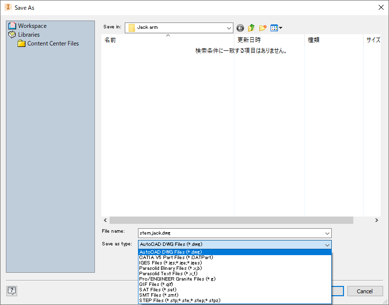

The "Save Copy As" option in Inventor 2022.0.1 does not allow me to export JT, OBJ and STL.
How do I export these files in Inventor 2022?

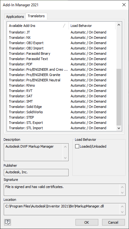

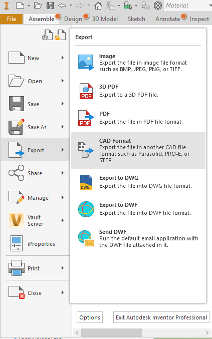

Does "File > export > CAD format" still allow for those file types?
You can also check the addins (translators tab) to see if those are loaded properly:

2021 has it, but 2022 doesn't seem to have it.
These are in the list of add-ins.
