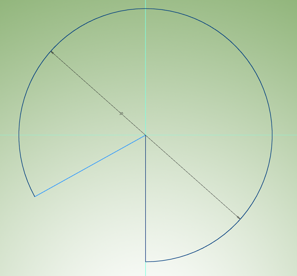

Silly workaround, but perhaps it helps:
Draw a "pacman":
Add an "arc length" dimension:
And use the following formula:
Does that help?

Hi! The confusion here is that the parameter value and dimension display are different. Geometrically, they represent the same thing. The actual parameter value can be any angular value except negative value. The display value is based on the closest angle between 0 and 180.

Hi! As the prior discussion pointed out already, there is no way to specify angle larger than 180 in a 2D sketch. It is a limitation for now. Another workaround to consider is to create an angled workplane (before the sketch). This workplane should be perpendicular to the sketch plane but rotates around an axis penetrating the sketch. The workplane can rotate from 0 to 360 freely. Then project the workplane to the sketch. Use the angular parameter to drive the workplane instead of an angular dimension.
