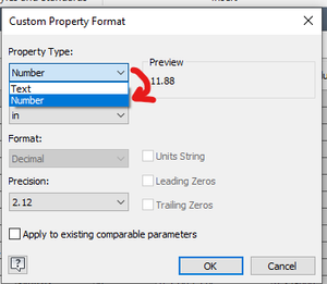

  7. Open the Parameter dialog box and find the Parameter you want to call on again.
  8. Right Click on the Equation and "Select Custom Property Format..."Parameter Export2.png
  9. Next Dialog box, change Property Type to Number. (Also you can adjust precision here as well.)d114f3c9-8055-40c3-ac60-4202d1841f74.png
  10. Press Ok and return to your iProperties and you will see the "in" is now gone like we wanted.
    Example: "Example text, 9.88", More Example Text"
