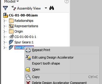

I was working on splined hub and looked into this a bit more.
I know using Export Tooth Shape (right in the browser on the gear) will give a better profile.  I use it sometime to get a better fit for laser cut to fit on a hub.

Message 5 of 14
DANIEL.CHASE
I am having a difficult time seeing where you "Export Tooth Shape".  Can you screenshot that so I can see where you are clicking on that option?
Message 6 of 14
Right click on the gear in browser in the assembly you create the gears.
This will create another part file with the teeth profile.  Tolerance is how accurate the profile will be.
You can add backlash to make the profile bigger or smaller.
This will help to make a drawing for inspection.

DANIEL.CHASE
I don't think this works for involute splines, just for spur gears.  I do not see the Export tooth shape option for Involute Splines.
Using Inventor 17
Message 8 of 14
You're correct.
Spline is handled differently by Inventor.
