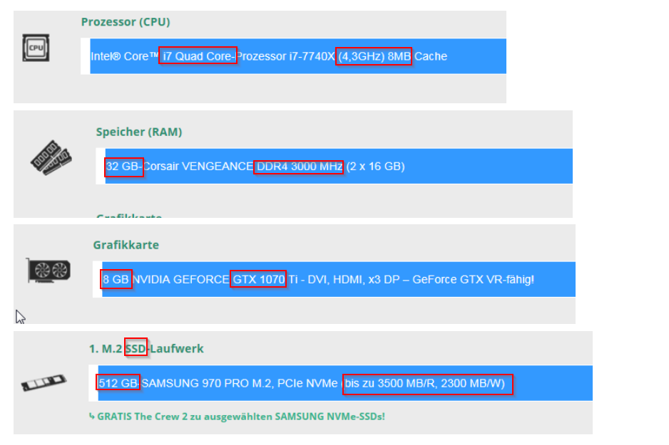

S_May
Now we know why inventor is running badly..
2018-09-18 16_47_53-Betreff_ Inventor Pro 2019 slow and jittery on Windows 10 (1803) - Autodesk Comm.png
Here is a hardware profile which is not expensive but very good:
https://forums.autodesk.com/t5/inventor-deutsch/inventor-2019-welche-cpu-welche-grafikkarte/td-p/821...
2018-09-18 16_55_18-Gelöst_ Inventor 2019_ Welche CPU, welche Grafikkarte_ - Autodesk Community- Int.png
