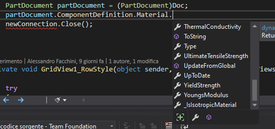

The part  with that material has not this property. We can't detect this characteristic also with I-Logic
