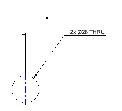

Hi. I am currently dimensioning a drawing for an American customer.  I have to give the dimensions as x.xx [y.yy] (imperial [metric]).
All going well until I use the Hole Note. I cannot get this to display the dims in the correct format. I've tried messing around with the Dimension Style/Alternate Units/Dual format, but nothing seems to work.
A workaround is just to dim normally, then edit the text - but it doesn't feel right!

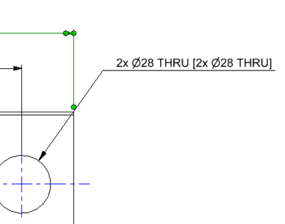

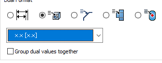

Below is a screenshot with the following settings:
Shouldn't inches be displayed (the primary units)? Instead mm are given

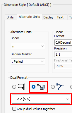

When I change the settings as you suggest
I get.....
It seems to be reading mm as primary and secondary dimensions

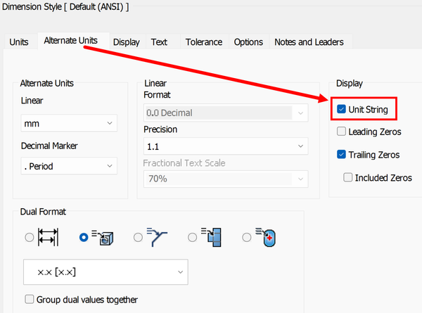

Inches also don't show the unit here for me, but try check marking this option to show "mm":
