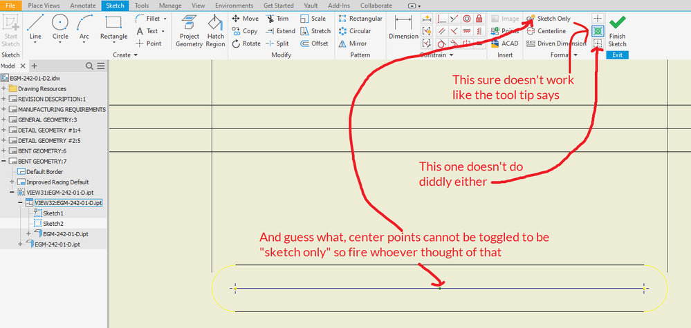

Sure, there's other ways, but I want the tidiest method for this drawing.Sure, there's other ways, but I want the tidiest method for this drawing.
I hope this is just a bug, but.....

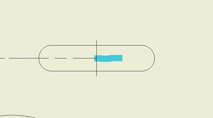

Why the **** can I not place a center-mark at this point I've created from a sketch????
Why does the snap feature not work?
Why do some center points change like this after I add a centerline???

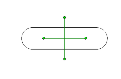

mcgyvr
Ideastation request to add a "slot center point" function to Inventor..
https://forums.autodesk.com/t5/inventor-ideas/center-mark-for-slots-in-drawings/idi-p/8865063
Show your support there..
Message 3 of 23
mcgyvr
And a rather easy method to achieve a center point in the center of a slot is to create a workpoint in the model using the "center point of loop edge" workpoint creation method.. Then simply right click on that workpoint in the drawing browser and select "include"..

janelson33
@mcgyvr Thanks for the tips, and I will certainly upvote that idea!
I still don't get why the centerline does this to the first and last Work Point marks, but it is progress in the right direction. I'll just stretch the center-line to look proper in this case.

johnsonshiue
Hi Jarott,
Indeed, it would be much nicer if center mark can recognize a slot center. Another way similar to Brian's approach is to leverage the slot sketch. If the slot was created using Slot command in 2D Sketch, there should be a center point already. Simply make it visible and create a workpoint on it. Then include it in the drawing.

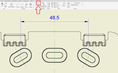

SEC_CAD
I had exactly the same issue with dimensioning to the centres of slots. Here is how I solved it:
1) Use the CENTERLINE BISECT tool between the edges and curved ends of your slot.
2) To dimension to the center select DIMENSION then select one of the centre lines. Right-click and choose INTERSECTION then click on the perpendicular centre line. Do the same for the other end of the dimension.
