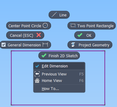

I am not sure there aren't two different issues in your description.
Your in ipt sketch, right?
1. When placing a dimension you can initially edit if Edit Dimension is activated.
From time-to-time I have accidently deactivated that when using gestures.
Drives me crazy, but easy enough to turn back on.
2. Once dimensions are initially placed though, it is a double click action to edit.

Teepee101
Same issue 2024, here's where to switch it on
