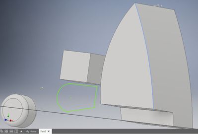

Hi @johnsonshiue
This is what I've have so far:
Hope it doesn't look like a iron-box
I cannot get to edit the sketch to get wood panels.

err... what? Thats really challenging my brain today to comprehend how that is anything like what you have shown in the image above.. Smiley Tongue
One of the best tips about Inventor is keep it as real to life as possible.. If you want a table in the real world you make a leg part (4 times) and a tabletop part..
Then you assemble them together..
This should be the same.. Thats totally an assembly of multiple flat sheets of plywood or something so model it as such in Inventor..
