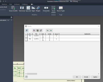

I installed the latest version of Inventor and I have a problem (I tried on two different workstations): when I start writing in the fields of the table, the characters disappear and I can't see what I write. When I leave the field, the typed text magically appears. So the data is entered, but you can't see anything as you type in the fields. That i a big problem for me, because I make extensive use of tables in my drawings.
Do you have the same problem?
Any idea?
Thank you.
Luca.

Hi! We do seem to have a table editor issue here. Another user reported a similar problem last week.
https://forums.autodesk.com/t5/inventor-forum/inventor-2024-bug/m-p/11886546#M893533
I am working with the project team to understand the issue better.
Many thanks!

Hi! Unfortunately, it is indeed a confirmed defect on 2023.3 and 2024. It has been reported as INVGEN-68675. Hopefully it will be fixed soon.
Many thanks!

Hi! The fix to INVGEN-68675 should be included in 2022.5.1, 2023.3.1 and 2024.1 (and 2024.1.1). It is possible I misunderstood the issue. Could you share a screenshot or a video showing the exact behavior?

Yes, i have resolved the problem. Please install last update for Inventor.
