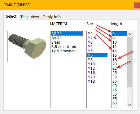

When I place a item such as a hex nut from the Content Center the list of nuts isn't sorted correctly.  See the attached screen shot that shows a 3/8" hex nut after the 3" hex nut NOT at the top of list after 1/4".  After you see the problem the size needed can be found but can't Content Center list the parts in the correct order?

sorry for the sorting issue, we are aware of it. Sorting issue is tracked in our tracking system as the INVGEN-58801.

The latest status for INVGEN-58801 shows that it has been fixed on internal builds targeting 2022.3 update and 2023.1 update.

After some testing I found a solution, just open the spreadsheet in Excel and use the sorting functions to rearrange the spreadsheet to your liking. Apparently this applies to the sorting in the selection dialog.

I am on 2022.5 and I am having issues. We would like to have the sorting as it is written in the ContentCenter table, as it has been for the last 12 years at least. @johnsonshiue has written that this has been fixed on 2022.3 but it does not appear to be the case.
QUESTION: How do we get the members in the mask sorted as they are in the content center table?
Why we need it
We sort the ContentCenter table as member shall appear on the mask. If we sort the table this way
Content Center table in Inventor 2020Content Center table in Inventor 2020we want that the mask appears as follows
Content Center mask in 2020Content Center mask in 2020
This has been working fine for at least 10 years, and we have very good reasons for this specific sorting: the members in the red rectangle are "non standard lengths". Therefore we give to our designers a visual feedback of which are the standard lengths: the ones on the top of the list (3, 4, 5, 6, 8, 10, 12, 16, 20 in this specific case).
The same in Inventor 2022.5 reacts completely differently: here is my table, sorted as it has always been
Content Center table in Inventor 2022Content Center table in Inventor 2022
but here is what the mask shows, which is undesired and different from previous behavior:
Content Center mask in 2022.5Content Center mask in 2022.5
Here the length "4" (non-standard) appears on top of all others, and our designers will mount a non standard length thinking that it is standard, which is heavily misleading. The lengths "4", "35" and "40" should appear under the length "30", exactly in the order specified in the content center table.

we got request related to "keeping old sorting" from our Autodesk product support guys. We are aware there are people they want to define order of items in Content Center family dialog via Excel by themselves. FYI, this request is tracked as the INVGEN-73055 in out tracking system.

This may be irrelevant, but the way I sort items in the CC Family Table is to make a new column called 'Sort' and then add alpha-numeric values to each cell so the table sorts correctly.
So maybe you can use my work-around to accomplish what you want?
To do it you add a new column, then copy all values to it from your existing sort column.
Than add an 'A' prefix to all the sizes you want listed first, and add a 'B' prefix to all sizes you want listed next.
Then sort, save and close.
Then check the 'mask' to see if they retained their CCFT order?
