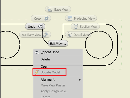

I created a presentation file in 2020 version. When I placed in the drawing file it shows the exploded view. However when I tweaked some more components in the presentation file, it cannot updated the new tweaked components. I attached the screenshort file here

Hello @lis_wang,
Check the context menu for the view and click update model if it highlighted.

The "update" is grey so there is no need to update. I attached my inventor files here.

Hello @lis_wang,
Oh, I see the case.
Just move the view marker to the end and refresh view 1, now you are all set.
