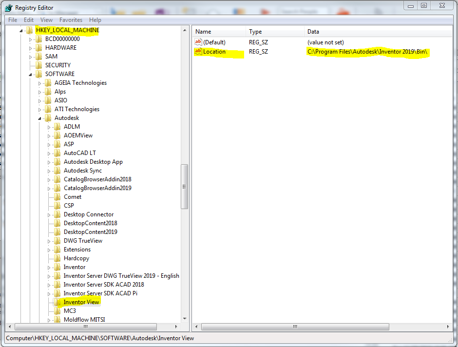

krm
Community Visitor
Community Visitor
It did not work until I added this file:
@ChrisMitchell01 wrote:
A few remote sessions were hosted with @eric.roades & these workarounds addressed Copy Design & View in Window not working:
  • Run regedit
  • Create a Registry Key called HKEY_LOCAL_MACHINE\SOFTWARE\Autodesk\Inventor View
  • Under that, create a String value called Location
  • Set the value of Location to be the path to where the InventorView.exe resides on disk. Eg: Location=C:\Program Files\Autodesk\Inventor 2019\Bin\
 Copy these 11 files from the ...\Autodesk\Inventor 2019\Bin folder to ..\Autodesk\Vault...\Explorer folder :
Please ensure to backup the entire Explorer folder prior to doing the file copy.
  • Launch InventorView.exe as Administrator.
  • Launch Vault Basic 2019 as Administrator.
  • Copy Design should now work.
The following was needed to get "View In Window" to work:
  • Launch Inventor.exe as an Admin which prompted to Choose “Yes” for re-registration, (may be followed by usual subscription login or other licensing messages).
Once the re-registration is completed, View in Window should work.
Could others with this issue please try these workarounds & report back here ?
Chris
