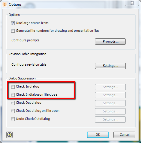

Mine just started happening earlier this week (Aug 21/17).  It freezes when opening a file, and I have to end it through the control panel.  It doesn't give me an option to send an error report.
Not being able to check files into the vault also started this week too.  At first, the attached message flashed very quickly, now it doesn't.  It seemed to freeze here too but escape let me work in the file again... but still not checkin.
Are the two related?  I just did the latest hotfix with no luck.

Message 57 of 62
rachel_li
Hi Robyn,
for the first message, "one or more documents have been modified but the save was unsuccessful. You must save the document prior to check in", this is due to some files referenced in the assembly are read-only so that auto-save cannot performed. Save the files manually by Save button and then do check in, it should work. If you have all the files checked out, you don't need to save the file with a new name.
For the second message, would you mind sharing me the dataset for further investigation?  (you can send to my email if the model is not large, or I can provide you a location to upload you data. [email protected]) When you say still cannot check in, do you mean the Check In command is grey out or still get the first message? If you have the file status in Vault like the image you attached in previous post, these files are already checked out.

This morning, I opened an assy and tried to save it.  Gave me the "already exists/read only" message.  I then checked it out, save, and it saved fine.  However, it still won't check in and I still get the "Identifying suppressed files" message.  Note, Vault has always prompted me to confirm the files I want to check out but has stopped doing this.  Vault settings are set to "always prompt".  It seems to hang when I open it and I have to hit escape for it to finish... almost like it was waiting for me to click something but there is no popup window. (see below)

The message "Identifying suppressed files" to processing file is expected before Check In dialog prompts. It flashes if it is not a large number of files needed to be processing. Looks like the Check In dialog blocks the window. How about try to suppress the Check in dialog and execute the check in command again? Inventor Ribbon Vault tab->Vault Options->Check the check box of Check In dialog. Then the check in dialog will not show and execute check in automatically.
Note, for confirm whether to check out message, if you have already have the files checked out, the message will not prompt. If you open files from local workspace not from Vault, the message will not prompt even you have not checked them out, but when you try to edit model, the message will prompt.
But if you just mean the check out dialog which list the files will be checked out, please double check if the options to suppress check out dialog is checked in above dialog.

Thanks again Rachel.  I always open from the vault then check everything in, and delete temporary files when finished.  I no longer see this window.  I checked the settings and they are as you indicate but I am still getting no prompts.  I just don't get why hitting escape seems to unlock the hangups.  If I go to the vault, hit checkin, it shows me the window with the option to keep temp files or delete.  I then get message saying I have to check files in through inventor which I have seen before so expected it.
