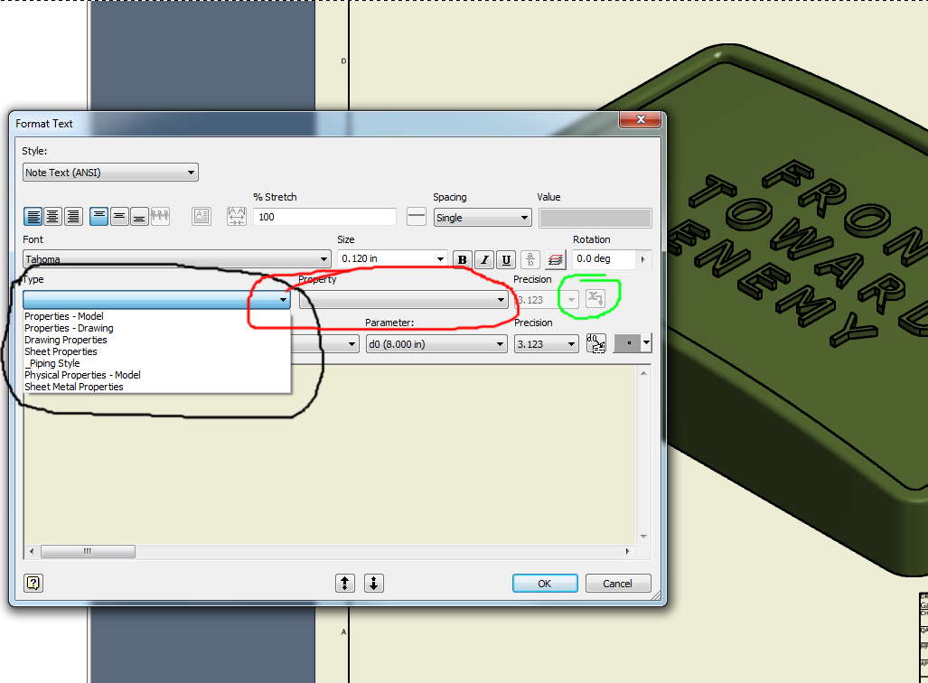

Okay, so this is a screenshot of the text edit window that you get for pretty much everything in the drawing environment.  I've circled three things in it.
Use the pulldown circled in black to pick the type of property you want to access.  These properties are drawn from one or another of a variety of other sources.  The pulldown marked Property, circled in red, is where you pick which individual one you want.  The button circled in green will insert the value in the text box.
The only way to pick which model or assembly you pull these details from is to make sure that you put the one you want to use on the sheet first.  Hopefully this will change in a future release ... there's times when I have planned poorly and would love to be able to change where these data points are captured from, but the only way to do that is to start a new page, put something different on the sheet, then copy the rest of my views over there.
The sheet metal extents that you were looking for are located - perhaps obviously - under SHEET METAL PROPERTIES on the TYPE menu, which is the one circled in black.
Rusty
