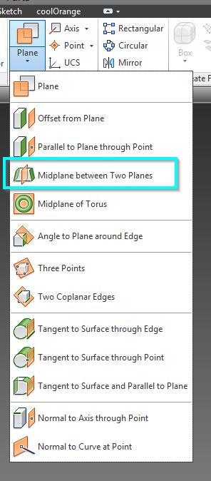

To create a middle plane between to planes (or planar faces) you just have to do this:
Seletc "create new plane", then select both planes (or planar surfaces)... and that´s it, you will create the middle plane.
Tip: The planes doesnt have to be parallel with each other. It´s possible to create the middle plane (Bissector) between two angled planes (or surfaces)
Also you can use the filte below

Where can I find "create new plane" command?
Message 13 of 16
CCarreiras
Check the image in previous posts.... it's the top button...

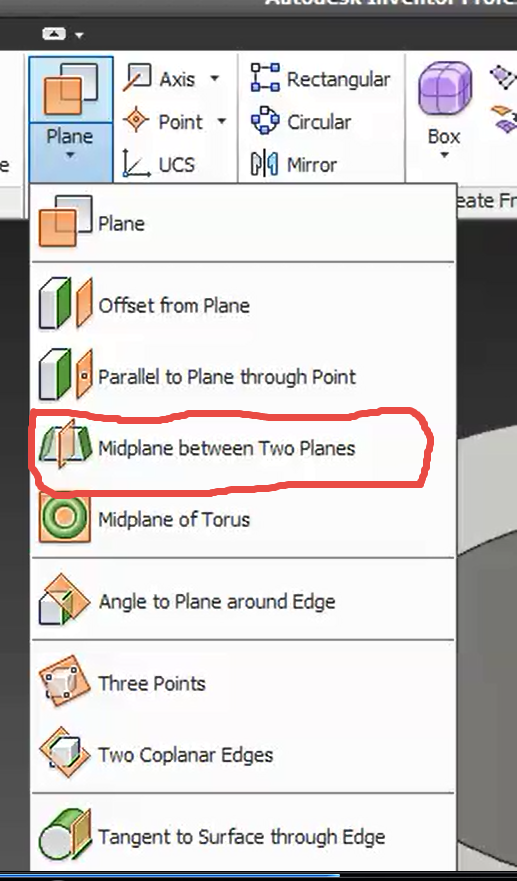

Midplane between two planes command is doing the job. But why demonstrator is not doing such way?

Because you don't need to use the filter........ you can just pick new plane tool, and then select both faces....
Go have some training, will help you a lot with these basic questions...
