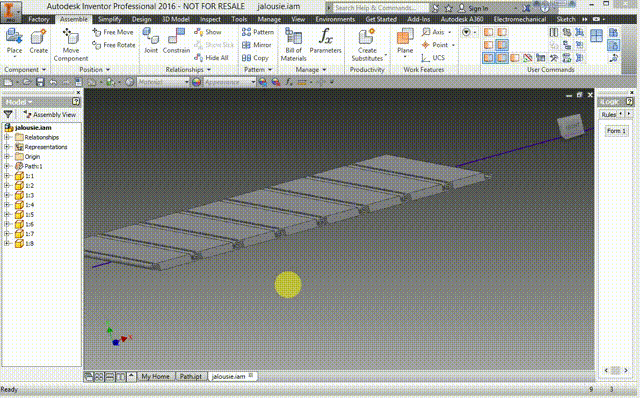

I wonder if it´s possible to make a jalousie in Inventor and also let it follow a bend curve. I also want to simulate the movement in an assembly.
My plan is to make the jalousie as one plastic part with allot of pre-bends.
My basic example is made of an extrude and a pattern. I tried pattern on "curve lenght" with orientation "Direction 1" with no progress.
BR/Goran

I have attached an example how I wish my design should looks like. I want the jalousie to follow the curve in sketch4. I suppose "workplane 1" can be a copy of a driven plane in the assembly so I can control the movement.

You have to think about to things:
One: how the inventor is gonna give movement to the assembly?
Two:How it will be, the movement?
Create a part (Path.ipt) with a path (sketch + Surface), with a work point. Pattern the work point along the line with a variable (Let's call it "Move").
Constrain the first jalousie part with the work point. As the point moves, the part follows. Constraint all trhe other parts to the first one.
Also give a constraint between the part and the surface (Must be "Transitional" Constraint). Then, vary the constraints and the system will move.
You can do this in Assembly environment, or in studio environment.
Tip: create construction elements and surfaces to help constraint the part with the path points and for transitional constraint.

Here is an example near what you seek (simulating only one flexible part, but in the end are several parts).
I leave the parts free, so you can drag mannually to test.
If you want to make it "automatic", mate the axis from the first element with the point from the path. Open the iLogic Browser, go to forms, open the form and drag the ruler to put the point in movement.
WARNING: dont make abrupt movements or the system will be a mess. offcourse you can rearrange it with free move and free rotate to reposition the parts, or simply make some undos.
Files in attach.
