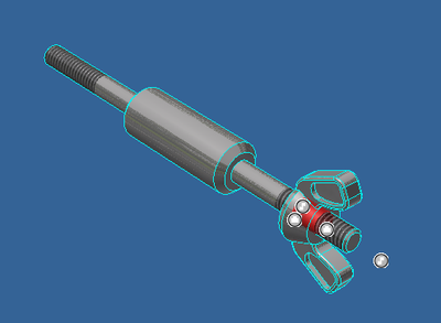

Interference is detected. I tried to change wing nut to “Major” option but I couldn’t because box is blank, there is no option to select. How to fix it?
Wing nut is placed from content center.

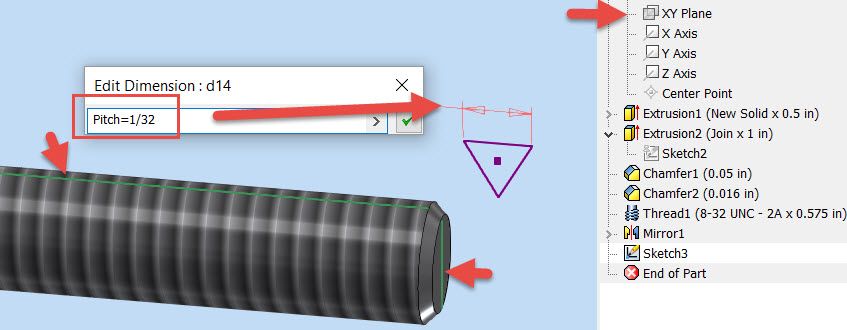

Since you couldn't make a decision - I will make it for you and then walk you through understanding threads.
Since your shaft is 8-32 UNC, lets pick that size for both the shaft and the wingnut.
So to be clear - I have made the decision it is 8-32 UNC (later we will see what happens if I had selected either of the other 2 sizes).
Let me work up starting example - back in a minute.
OK,
Open the Shaft part.
Start a new sketch on the XY Plane.
Project Geometry the top side of the cylindrical face and the end face as shown (green lines in image).
Create a Polygon with 3 sides.
Add a Horizontal constraint to one of the sides.
Dimension with the equation shown.

There is a another problem as well. In the cross section I couldn’t see any cross section of thread.
Message 30 of 60
Message 31 of 60
JDMather
No wonder you are having trouble understanding threads.  I thought we covered the topic of cosmetic thread representation vs modeled threads months ago.  I thought I instructed you to zoom wayyyy in on a cosmetic thread months ago.  The cosmetic thread is simply a picture wrapped around the shaft or hole - no real threads at all.

Now cut the physical thread and compare to the cosmetic thread.
Then attach the Wing Nut here and I will demonstrate how to cut the internal thread and then test the assembly of the two components.
There might be a bit of confusion in the video as Inventor refers to the Coil Height (for length of thread) where I used the name Thread_Height for the distance from the root of the thread to the crest of the thread.  Note that these are two different "heights".
