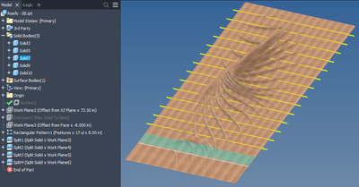

I think there's something wrong with the geometry.  I was actually able to place a Hole feature, even with a countersink, but calculating it took several minutes.
Inventor could not split the body using the XY plane, but I was able to create a 3D sketch and create two intersection curves, one on the top face and one on the bottom using the XY plane.  The interesting thing I found was that the two curves crossed each other, so this geometry is definitely not right.
Update: I managed to separate the two faces by using Copy Object to Surfaces, then deleted the top face (the one with minimal contour) as well as the repaired composite.  I then created a workplane close to the surface and extruded the outline To Next, making it a solid body, sort of like a large carved sheet of plywood.  This is now editable using all the normal tools, so I set about splitting it into planks using a pattern of workplanes (see below).
The attached file is Inventor 2025 format.

Impressive! I recombined the bodies and slatted the feature as planned. Updated model attached.
I still don't understand how you separated the two faces. That interfering geometry was stopping me from trying any of my usual tricks.

Knowing what I know now about the file, here is how I would do it when opening the .stp file originally:
Choosing Individual surfaces instead of Composite I do not get two interfering surfaces, I only get one surface:
This eliminates the problem, allowing manipulation of the surface or conversion to a solid by thickening or extruding To Next.  I don't know why the Composite option creates two surfaces and Individual creates only one.  Perhaps Inventor's conversion tool is a little buggy?
