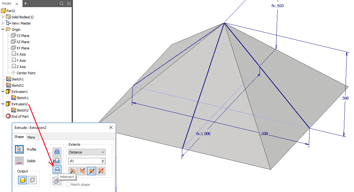

Here is another example using Extrude Intersect.
You can get lots of good shapes generated this way from different views (Front, Right, Top) of 2D drawings.
