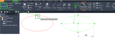

Our company, which sells office furniture, wants to offer an elliptical shape table. My project is to model and draw the table top. The modeling part is easy. I  just used the elliptical tool to create the sketch then extruded it to create the 3D shape.
Next I started a new drawing, placed a top view and began to annotate it and there is my problem. The general dimension tool will not select anything other than the outside shape. I need at a minimum the radius of the major & minor axis. See screenshot below.
Another post suggested use Retrieve sketch dimension, however in my Inventor (2021) I can't seem to find that option. For example, in the Edit View, under Display Options, there is no such command. Under the Recovery Options tab, there is an All Model Dimensions command that is grayed out.
So, I am at a loss as how to dimension a simple thing as an ellipse. I've spent quite some time searching this forum but haven't found anything to help so my last resort is to post here. Surely someone has needed to make a drawing of some ellipse shaped object and run into the same issue.
Thanks for your help,
Steve

I just use the out-of-the-box dimension tool and it works fine for defining the ellipse:
CCarreiras
Hi!
Fist, just create the view, (click ok in the image you posted).
Then go to annotate  tab and select "dimension" to start creating dimensions:
Select the geometry, you will find several green dots to attach the dimensions.
Tips:
you can create a center mark to help you attach the dimensions. Check the image below.
You can use retrieve dimensions, it's on the annotate tab, orange circle in the image

sdreed52
Yes, that does work on a normal 3D created ellipse. I hadn't noticed the green dots before so thanks for the tip. My model was created (by someone else) using iLogic. This model seems to be different for some unknow reason. It isn't a spline or polyline but still behaves differently than an identical model I created myself.

sdreed52
Yes, that should work but doesn't in this case. The original model was created (by someone else) using iLogic and it will not dimension like you indicate. I recreated an identical model and it will dimensions as you show. Their model should work, it is just a standard sketch and extrude driven by the iLogic rules but for some reason doesn't.
