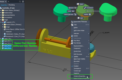

You can have different instance numbers for the same parts (And same Part Number)
Select all the group elements and create an instance variable (i created POS) and give the value you need for each group.
In BOM, set this:
Now the same parts are splitted by POS variable (Instance variable)
