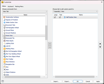

clamhaich
A work around solution could be setting up a user command in the view tab:
Right click on the ribbon and select "Customize User Commands"
Set the dropdown list on the right to " .... | View" and add "Half Section View" to the list:
This will add half section view to the ribbon:

Thanks! That is what I have done for now.
