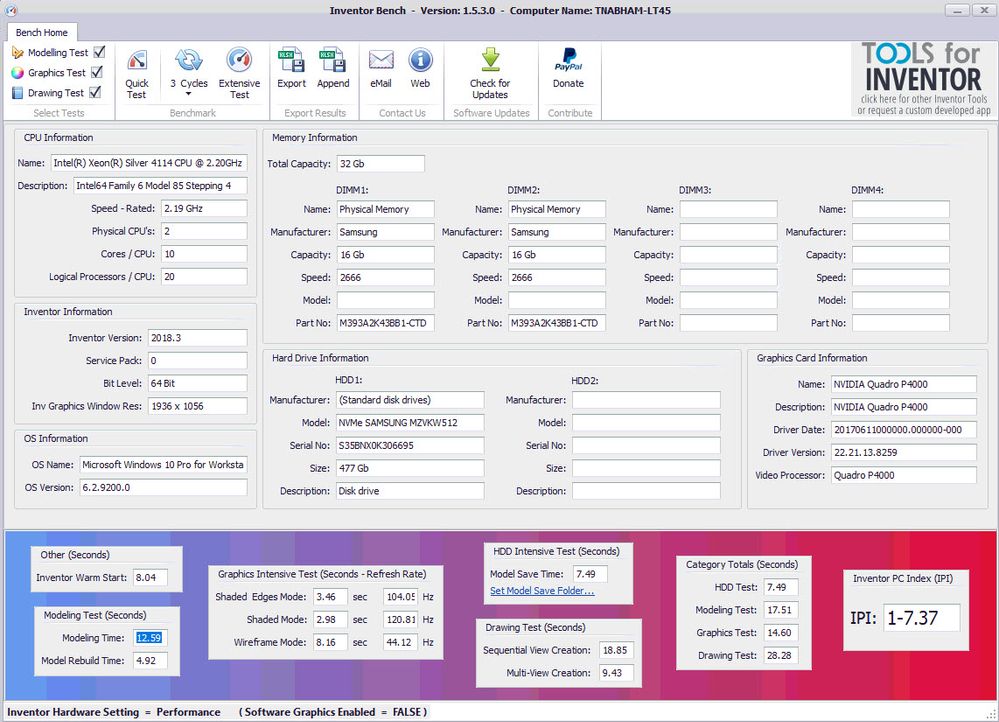

Neil_Cross
in reply to: Neil_Cross
So yea, here's a $7500 brand new Lenovo workstation bought for an engineer using Inventor, and it's worse than a PC I built for $450.  I gave the IT team a spec and they went off and bought something totally different, a dual Xeon box with two CPUs designed for data centre servers.  This is hilariously shambolic.

pball
@Neil_Cross
I would love that computer for doing other things, like video encoding. But would probably murder my IT department if they gave me that for Inventor usage. I'm lucky that we are a small company and I was in charge of the specs with IT making minor changes like choosing the gpu, psu, and case brands.
It's painful to see a pc that costs 3 times as much do half as well.

peter.ensing
@Neil_Cross Its like you have shown earlier that CPU core speed is key in this matter (except rendering and stuff).
I've got a pretty old pc but it scores high just because of the fast CPU.
I made the same mistake for Solidworks 2 years ago with a dual Xeon CPU, 40 hyperthreaded cores total.
It was a beast when it comes to rendering and calculating Scia Engineer. But for both Solidworks as Inventor it isnt much of a performance boost for modeling and drawings.
I guess you just have to buy the right 8th gen Xeon CPU with a minimum turboboost to 4.3 GHz.

Neil_Cross
in reply to: peter.ensing
When I spec a workstation for someone I always ask what else they plan on using it for, if it's just Inventor usage then it'll go one way, but if they use Ansys or something else as part of their typical work then I'll make compromises so that you don't completely handicap one application by benefiting another.  It can be a tricky balancing act whilst also considering budget restraints.
But your test there is a textbook example of the CPU dominating everything.  I've posted results using a GTX1070 GPU which has a lower graphics score than that, because the CPU I had for that test wasn't as powerful.  The 4790K even today is still a formidable CPU.

leowarren34
Going to be honest Xeons IMO arent really that great for Inventor unless you want to render or do tasks that can be parallelised as they just lack the clock speed- A 6 core currently is the sweet spot as it allows for some multitasking without sacrificing clock speed which you have to do if you get more cores; I have a 7800X OC to 4.5gHz and it works a treat however my ram and GPU - from my old rig are my biggest limitations. My recomendations are a Core-X series CPU as they have the best power delivery and can be really well overclocked if needs be

peter.ensing
in reply to: leowarren34
@leowarren34 the 8th gen Intel xeon processors can climb up to 4.8 GHz. yes they cant be overclocked but they are pretty fast now days. If its for a home rig or small company I would recommend an i7 serie too because they are cheaper. But if you want more stability and insurance the new xeons are good to use.
