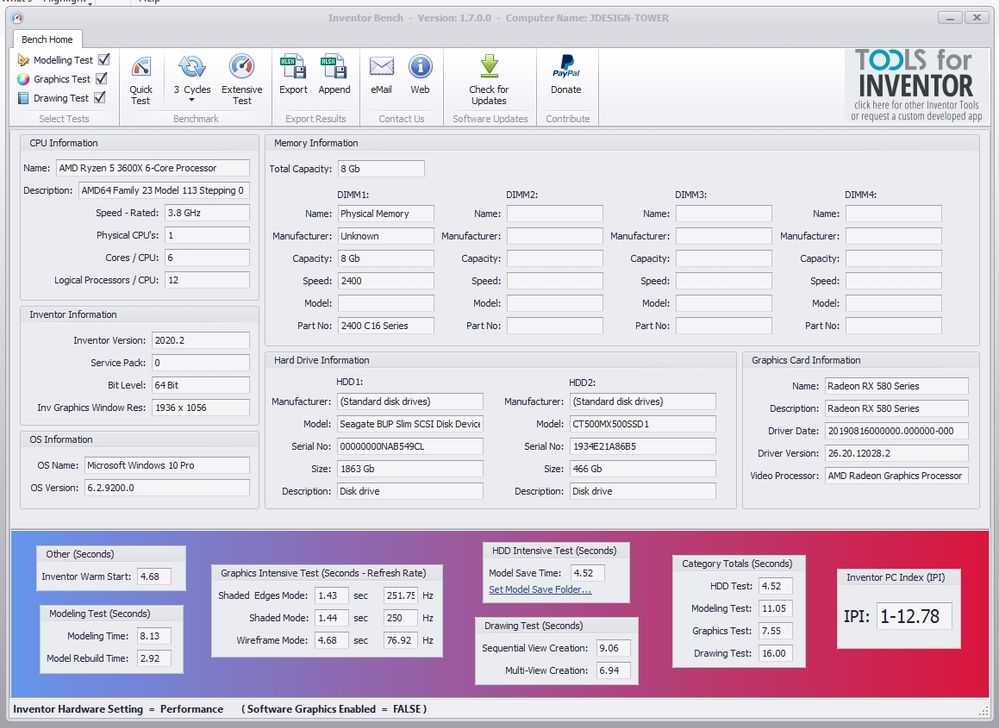

doug.johnston
I just finished my new tower build ... and I'm very impressed with the results using Niel_Cross' latest "Workstation Slayer" specs as a starting point.
CPU - Ryzen 5 - 3600x,  3.8 GHz base clock - 4.3 GHz factory overclock
MOBO - MSI B450 Tomahawk Max
GPU - MSI Radeon RX580 OC, 8 GB
RAM - Patriot - 8 GB, 2400
PSU - Corsair 850X, 850W
CPU Cooler - NZXT X52 AIO
Operating Storage - Crucial M500x SATA SSD - 500 GB
External Storage - Seagate SSD - 2 TB
Case - NZXT - H510i
- The RAM was purchased just to get the computer up and running, but plans are to increase it (using Corsair Vengence LPX 32 gb, 3200) after this global issue settles down and my job is a little more secure than it currently is.
- The PSU I bought for the same price as a 650W I was looking at.
- The External Storage, I purchased last summer for all my work related Inventor files.
I am extremely impressed at this system, especially the CPU, and even with the 8 gb ram, the system still screams.
A big THANK YOU to Niel_Cross for all your videos and everything you do for our community !!!!
Inventor Benchmark results ....
JDESIGN-TOWERJDESIGN-TOWER

Neil_Cross
@doug.johnston You're welcome, it's very rewarding to see the years of my hard work and testing to be in a position to recommend the optimal system is finally paying off.
For anyone else looking at this, the shopping list is here:
Workstation Slayer 2019/2020
Currently the parts list is roughly around $700 for the 16GB RAM version, but you can swap out parts and brands as and how you see fit but obviously leave the CPU and motherboard alone.
