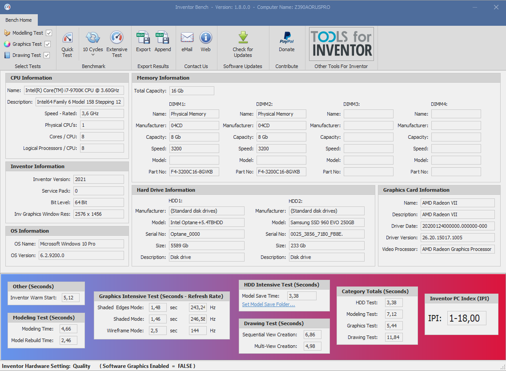

Had some spare time and put the all new Inventor 2021 in my home gaming rig. Here's what happened:
I dare say the IVBench score seems quite promising.
The 9700K was running 5.2GHz on the first 2 cores.

leowarren34
Geez @cfagerst Looks like you've won the Silicon Lottery!

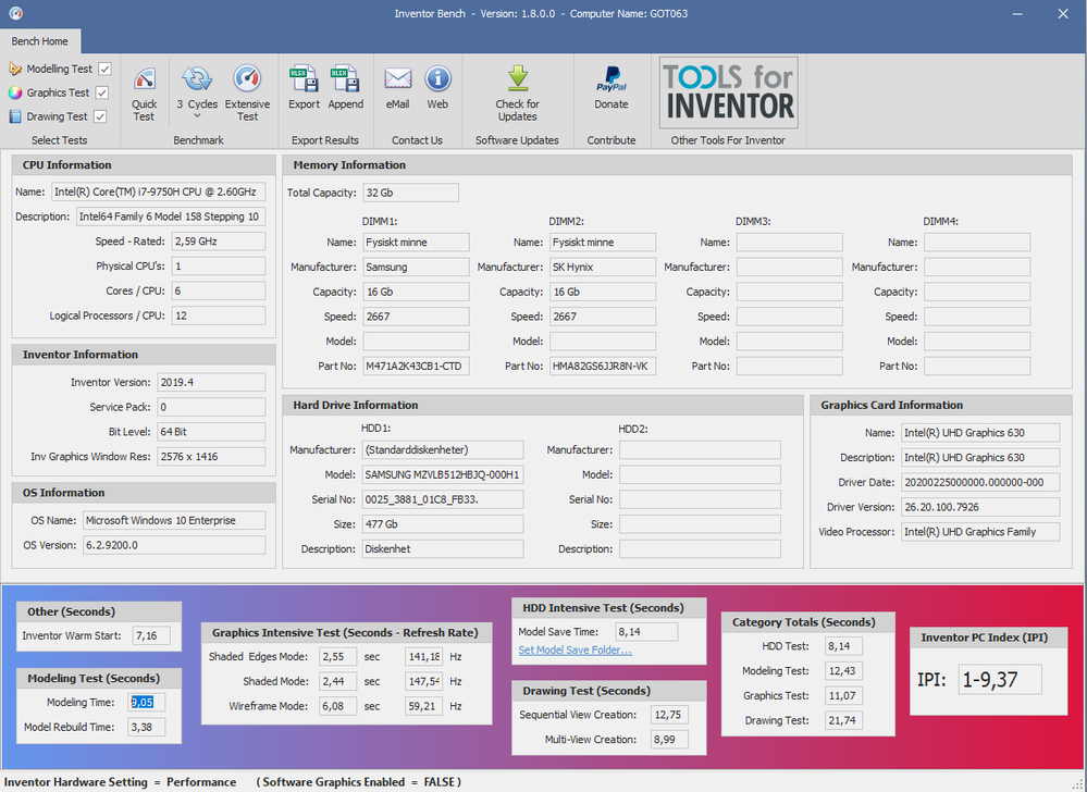

brunnic
HP zbook 15v G5

RNDinov8r
Curios, Niclas... HP touts that as a CAD workstation...their web page even shows it running solid works in the marketing pics, and it is certified by AutoDESK and SolidWorks, but with a score under 10, I am curious as to your thoughts on how it truly performs as a work station?

Neil_Cross
@brunnic your save time of 8+ seconds suggests that something is wrong.  On that laptop, it should be between 3-4 seconds, which means that something is interfering with the test, and it will be adding time to the rest of the tests.  That laptop should be in the region of 13-14 easily.
As you're on Inventor 2019, start by closing Inventor and the test, lowering your display resolution to 1920x1080, open them again and re-running the test.  That'll be a good baseline to start from.
If it's still way less than 13, investigate whether you've got other things open or running that might interfere.  Security programs which perform threat defence scanning of applications can do this too.
Message 1916 of 2,219
@Neil_Cross  Posted the print with the wrong account..
Will have a look on the save time. We have a few Zbook G5 and zbook 14u and they also have higher save time..
The laptop was connected to a docking station and HP Z27n high res. Will do the test without dock next time..
Will be interesting if it can hit 13 with the Nvidia P620 GPU..
Message 1917 of 2,219
@RNDinov8r
Our users have not complained so far 🙂 For our purpose it works fine. Using it for Inventor and Vault only. Don't know if it's good enough for other cad software with Quadro P620 GPU..
but for ~$1600 with the extra 16gb ram stick it's a good deal..
Message 1918 of 2,219
@Anonymous_Cros
Just a quick update, have not found anything wrong with the laptop.. Need to continue investigate but so far put a lot of hours into it..
But you should try it and to review. Half price against the Dell and what does that give you..
//Andreas

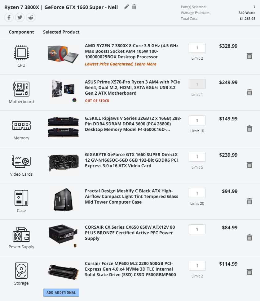

Hello everyone, I'm on a very tight budget so I'm working Ryzen builds unless someone can give
a solid reason to switch back to Intel (my fav personally).
I'm building 2 PCs - one that will run Inventor 95% of the time and the other will run Adobe Photoshop and Illustrator 75% of the time / Inventor 25%. I'm making this note because I may invest more in a solid graphics card for Adobe Creative Suite.
Might go with 3800x due to core 3.9 GHz though YT reviews say 3700x is plenty. That being said, they aren't running Inventor which this forum is suggesting operates on higher core speed.
I also chose DDR4 3600 because I'm learning that higher speed utilizes the Ryzen 7 CPU better.
I've attached 2 screenshots of builds.  First one is for the PC mostly using Inventor (thus the cheaper graphics card), and the second PC is mostly Adobe.
Is my overall thinking way off or do you have recommendations? Neil, I watched your video regarding Intel vs AMD so I'm a bit torn and indecisive.
Final note: Our current PC is i7-4790 with GTX 745 @ IPI of 8.04 (ouch)
Thank you! ~ Eric
Message 1920 of 2,219
If anyone has advice on my list please let me know. I replied to Neil but I'm not certain he visits this forum as often anymore. I'm working on a build under $1500 and hoping I'm on the right track. Having a bit of a time deciding on a motherboard as well.
