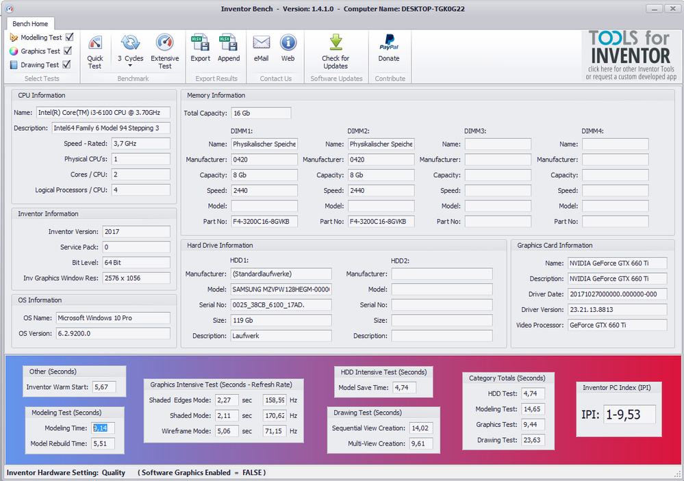

Message 1266 of 2,219
Neil_Cross
in reply to: Anonymous
That's an amazing score for that build, good to see.
150-170Hz on a very old GeForce 660Ti, anybody is welcome to go back through the thread and see how many newer far more powerful cards don't get anywhere near that because they're bottlenecked by CPU.
Just saying, again.

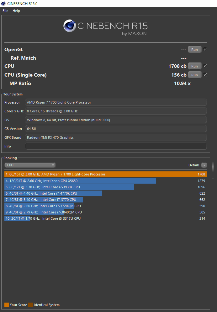

in reply to: Neil_Cross
@Neil_Crosswrote:
@blairwrote:
Normally I build a new machine every 2-years but looking at my system results I'm not sure that I'm going to see much improvement until the CPU clock speed steps up. I should re-run the test with Inventor 2018 to see if there is much of a change in performance.
Agreed.  Unless you do other stuff which could use the extra 2 cores you get now on the flagship i7, there's no massive gain from the 8700k over the 6700k for Inventor.  That's a good result.  I doubt Inventor 2018 would see it much higher.
Yep, for Inventor that really makes very little sense. I do other stuff too, including rendering with Blender and Cinema 4D. That's where many cores really pay off. Here are for example the results from a run in Cinebench on my rig.
https://ibin.co/3uQVK3aKh9mL.png
The good thing for my work using Inventor is, that I can submit a render job to Blender and keep working with basically no impact on performance. That's why I am really a fan of these new many core processors.
Hope that's not too off topic here.

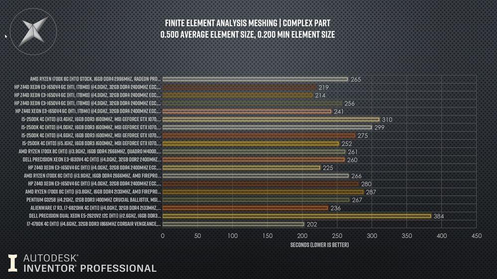

Message 1278 of 2,219
Neil_Cross
in reply to: blair
FWIW, these are my findings on how varying PCs with varying core counts and frequencies handle FEA meshing and solving.
4C, 6C = 4 cores or 6 cores etc.
