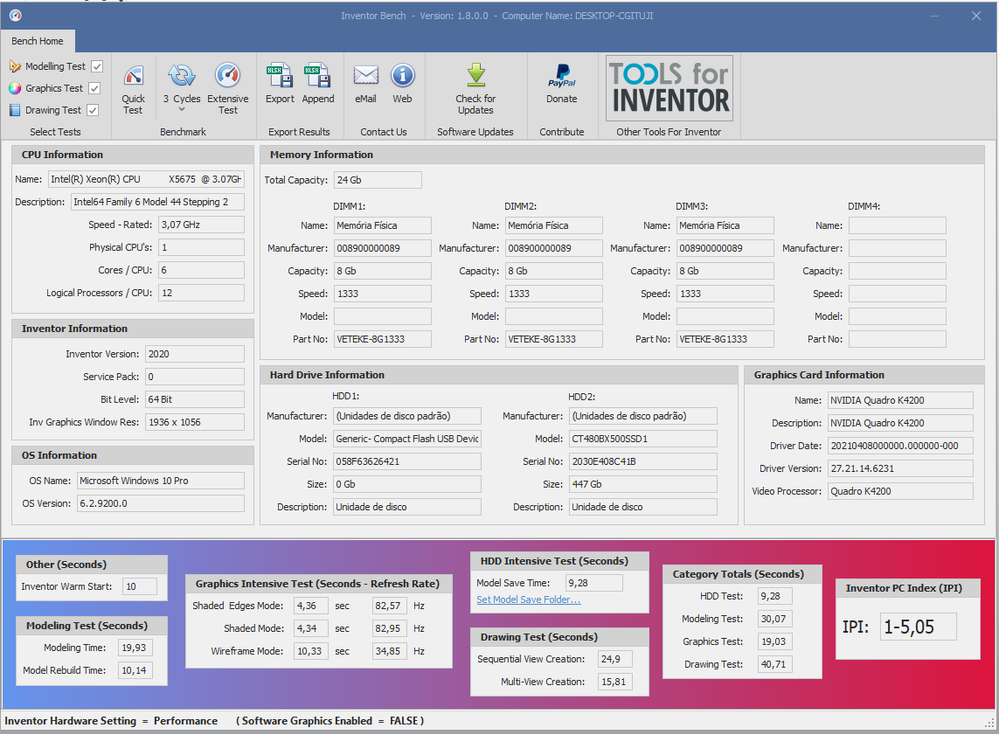

Capturar.PNGHello Users
I did this test.
The configuration of my computer looks good, but the results in the Inventor Bench are terrible. Would anyone know to tell me why?

Your CPU is ten years old. Not all 6c/12t and 24gb systems are the same. Capture.PNG

Hi @Anonymous,
In addition to what has already said above,
The main issue is the age of your platform.
The Xeon is 10 years old, which is extremely old for a computer, whilst each generation tends to be 5% faster than the last when the age becomes this big there have been seismic changes. Even the Silicon itself is 32nm which is gigantic compared to the 14nm on intel and even small on AMD.
Because of the age of your platform, you are also running DDR3 at 1333 MHz. Most newer platforms can run RAM at DDR4 2933MHz or above which is a significant speed difference.
The GPU could actually be alright for Inventor since it uses GDDR5 memory and whilst there are faster VRAM out there the GPU isn't used much inside Inventor with only the VRAM really mattering in regards to the GPU. Although 4GB is not much however should be fine for small assemblies.

Okay. Thanks for reply.
So is there anything I can do to improve using this platform?
A new workstation is out of my budget at the moment.

No not really.  Anything you do to that computer would be a waste of money.
Forget buying a 'workstation'.
For $600-$1000 you could have a PC that's blow your computer out of the water and score a 10-12 on the benchmark.

@Anonymous Just to add to @tgregory3G7FA,
That CAD Killer is an absolute beast, Neil has recently supercharged it with a 5800X which has been very high on the InvMark leaderboard. So if you get a 5800X at a decent price it will be so much better than your current system at a very decent price.

To add to that, an AMD 5600X system is at spot #4 on the Invmark leader board. So any 5000 series AMD Ryzen cpu is a good Inventor cpu, the higher you go the better your multitasking will likely be though.

@Anonymous
The nice thing about this build, if you don't have the funds for a 5800, you can start with a 3600.  Or even a Ryzen 3 3200 would be far superior.  And it's an easy upgrade to the 5800 in the future.
You could also probably be fine with your existing graphics card and SSD drive and save a few $$$ there.
BTW @Anonymous is this Inventor computer for business use or personal use?  If business, the question is, with a score of 5, how can you afford not to upgrade?

I have a similar build but it looks lime you have a mechanical hard drive. The cheapest thing you could do is getting an ssd an reinstall windows on that ssd. But you probably get just a few points in the score. Something about 9. However it will be a better experience.

He has an SSD. It says it in the results

Hi Mario,
Thanks for your comment.
I already installed an ssd and formatted the computer.
But even so, the result is insignificant.
Anyway, I appreciate your tip.
