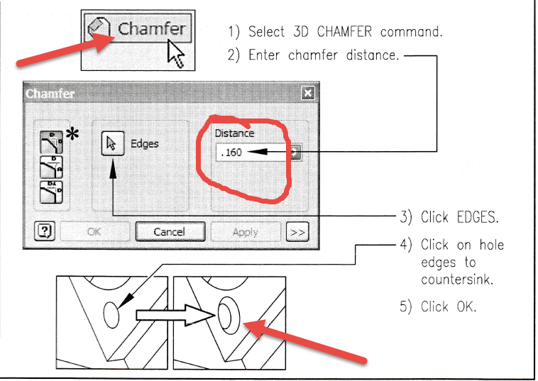

Message 21 of 34
In the college book author had used Chamfer tool to make chamfer to hole. Does Chamfer tool or Hole tool produce same result?
Message 22 of 34
SBix26
That is certainly one way to get there.  It depends on the design intent-- if you are creating a countersunk hole, for instance to use with a flat-head screw, you will want to use the hole tool with countersink, and the information will be called out in the hole note (as diameter and angle, not diameter and depth!).  If you are adding a chamfer for lead-in, or to remove a sharp edge, and will be dimensioning it separate from the hole note, then the chamfer tool is more appropriate.  In this case, the drawing determines the decision of which tool to use.
Another consideration is geometry.  On a flat surface, chamfer and countersink will give the same geometry; on a curved surface, they will not, and this difference will probably be important, depending on how the part will be fabricated.  For a hole on a cylindrical surface, a chamfer will produce a nice-looking part, but a part that may be very difficult to produce:
The one on the left is a 90° countersunk hole, the one on the right is done with a 45° chamfer to the same diameter.  The countersink can be machined with a countersink tool directly applied to the hole, the one on the right would be far beyond my machining abilities.  But for 3D printing, there is only a miniscule difference in cost, so function and appearance are the only considerations.
Hope this helps,
Sam B
Inventor Professional 2016 R3 SP1 Update 1
Vault Basic 2016 SP1
Windows 7 Enterprise 64-bit, SP1

Message 24 of 34
Thank you for your explanation.
Message 25 of 34
I wish to know whether it is possible to measure the depth of Chamfer distance created by hole tool is 0.016 inch.
Message 26 of 34

Message 28 of 34
Could you show me please.
Message 29 of 34
JDMather
Project Geometry (Project Cut Edges) in a sketch and dimension (or Measure).
or
Create 2D drawing and dimension.
Have you created ANY 2D drawings from your 3D models yet?
If not, STOP what you are doing and find that chapter in the book (or ask your instructor).
Message 30 of 34
I have not yet learned to create 2D drawings from your 3D models.
Message 31 of 34
SBix26
Does the Measure tool not work for you?  Use the Measure Distance tool, then select the flat surface, then the circular edge where the countersink ends at the hole, and there is your depth measurement.
Sam B
