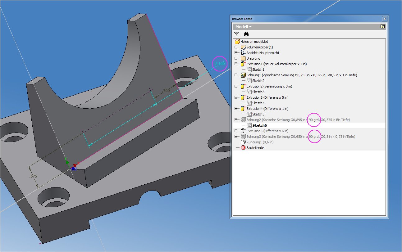

I have to make holes on model for that I wish to use HOLE tool. I made it but have many doubts. Dimension of the hole is given I need help to feed dimensions in hole dialog box. Particularly I don't have clue how to use depth 0.160

Use 90° angle instead of 45° in both cases. And compare dimension 2.100 with your input in Sketch6

There is slope between outer diameter and inner diameter which is given in the hole dimension. I couldn’t understand your 90 degree suggestion.

This face is wrong.

JDMather
@Anonymous wrote:
 I couldn’t understand your 90 degree suggestion..

Thank for show me exact angle position. How to represent 0.160 in the dialog box.
Message 10 of 34
What I know is going to Edit Sketch and fix the error. No idea about other methods.
Message 11 of 34
JDMather
You should note from my image that the dimension is (.160), therefore it is a reference dimension (Driven Dimension) and not needed.
Whoever wrote that book does not know how do dimension a CounterSink Hole.  That Depth value is redundant (and nearly impossible to measure with any accuracy out on the shop floor.

In my understanding as 0.160 is a Driven Dimension of the hole means that this countersunk depth is determine by the depth of the hole only. What is the depth of the hole? As the hole is an oblique one what depth can be given to dialog box.
Message 15 of 34
JDMather
Instead of entering a depth for the hole - I would set it to Terminate on this face (To).
Message 16 of 34
You can notice when "To" is selected OK button has become grey, no way to accept the selection. What is reason?
I wish to know what is ment by "To".
Message 17 of 34
swalton
It means that Inventor is waiting for you to select the terminating geometry for the hole feature.  Select a planer surface in the graphics window to control the depth of the hole. Once you have made your selection, the OK button should become functional.

SBix26
Whoever wrote that book does not know how to dimension a CounterSink Hole.  That Depth value is redundant (and nearly impossible to measure with any accuracy out on the shop floor.
While I agree wholeheartedly that dimensioning countersinks that way is an abomination, the depth value is not redundant, because no angle is specified.  When I tried this model for myself, I had a big nasty equation for the angle which made use of the depth: = 2 ul * atan((CSinkDia - HoleDia) / 2 ul / .160 in)), if I recall correctly.
