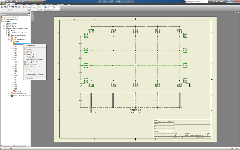

Here's a very simple example of how you can do it.
This took me an hour to make.
The 3d model, underlying 3d sketch and drawing were simple and took only a few minutes.
I erred when saying you can use a Symbol in the part environment.
I also mistakenly thought you have to use Blocks instead in the part file.
But Blocks don't do you any good for labeling b/c there's no way to make the label changeable like w/Symbols.
So I just copy-and-paste the circle and text, then change the text.
Once you have one row or column of labels done, you can copy them all and reattach to the gridlines on the opposite side.
Anyway, that's how I've always done it b/c there was no way to do it automatically.
I guess that's another simple applet that the developers have lagged behind in adding to Inventor...Gridlines and Labels. Even when adding the smallest layout and structure to an existing building or work area you need gridlines. One has to wonder who FORGOT to add that to Inventor?? I can't tell you hoe many times over the years I've done this. Sometimes the project was of the type that I had to do it in AutoCAD of all things b/c Inventor didn't have the capability for documentation that structural work requires. How sad!
Incidentally, I've done this using Symbols in the drawing file, where the grid was made either like above or in the drawing file using a drawing Sketch. But I found that to be way too much work. The way I show in the attached dataset works best b/c the one sketch follows all your drawings through to the end.
... Chris

cadman777
Your sketch looks good.
It's similar to my example in this thread.
So if it's in your assembly, then you're good to go.
I'm not sure where your method is failing, so try this:
Download and open the zip file in 'Message 7'.
The assembly shows a part file w/the gridlines in it.
Open that part and you will see it is like yours.
Then open the drawing.
After you place a PlanView, you go to the model tree and expand the assembly part down to the gridline part.
Then you expand that part and RMB on the gridline sketch and pick 'Include, Visibility, Display Text'.
That gets your sketch to show up in the drawing view.
It will only show up in a drawing view that is perpendicular to the sketch plane (or at least that's how my older version works).
If in your grid part you add points at every grid intersection, and label them by their location, then you'll have a means to connect to your grid when working in the assembly, or if you Derive it into another part and need to reference the geometry for location purposes.  You can see that in my gridline file.

C_Down-NRS
It was just the turning on the sketch in the drawing which I was falling down, am running 2022 so slightly different menu...
Working great now thanks.
