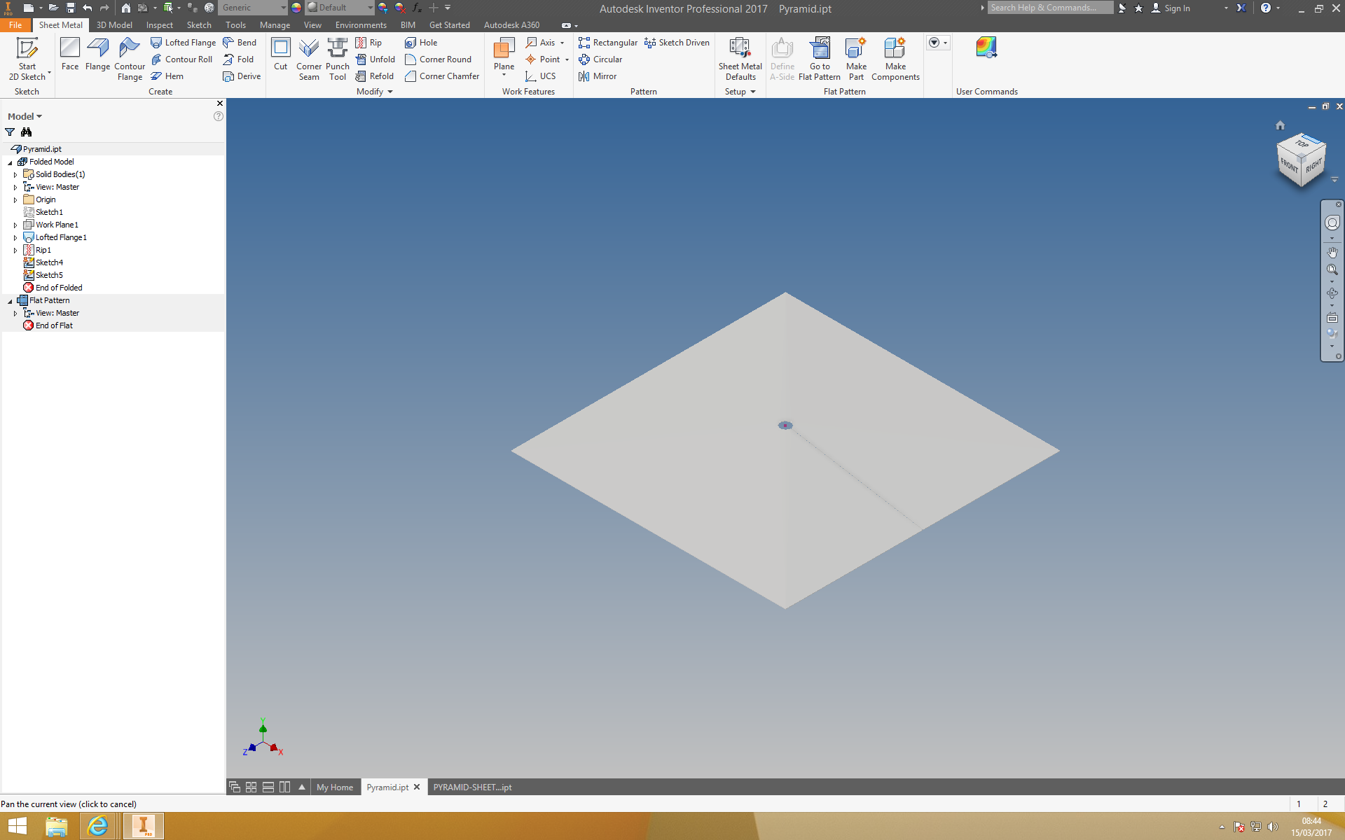

Message 9 of 12
Thomas_Savage
Look at my print screens, is this what you mean?
Thomas
Thomas Savage
Design Engineer
Message 10 of 12
Dear Thomas,
Thanks you very much

Thomas_Savage
You're welcome. Just copy what I did. Then you should be fine. If you get stuck just ask.
