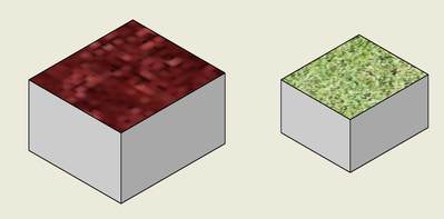

BDCollett
I did a quick test, and it works fine for me. It could be that it's a specific finish type that is not working.
I do have CoolOrange Powerjobs installed but using the out of the box Job Processor. It is possible the add-in is still helping this, I can't confirm.
Inventor/Vault 2024.2
Inventor IDW: Primary left, Model State 1 right.
PDF via the Job Processor:
Expected behavior currently with Model States and Visualization/dwf files not displaying non Primary. (Big flaw)
After changing the Finish around a bit, it seems to lose it completely in the visualization as well.
