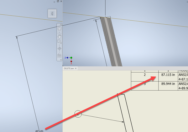

Issue is, No FX extrusion length. Where did it go.
When i do an extrusion I am selecting between feature then I use two working plans as my "TO" and "FROM" work plane distance. they are the angled work planes.
The dimension is shown in extrusion pop up with parentheses (86.703). when I hover over dimension it say d2 is my function.
The problem is, I do not get this dimension (d2) in the FX list. I want to export this distance to my bom list.

can confirm the parameter does not exist but noticed also there is no where you can pull that dim from, that would be my guess as to why there is no parameter?

the best I can do is go back to original sketch and put a reference dimension.  that shows up in FX.
I was wanting to get full length of part, but that seams not so. the model will have about 40 parts like this, just was looking for an easy way to show full length of pipe. the extrusion is just center length, but that won't work because of angle end cuts.

This Extrusion has no length - because you haven't defined it.
This is the distance range from - to. But from the perspective of logic, it is not a length, but a range.
You haven't defined length, so you don't have a length parameter.
The value controlled in brackets in the Extrude operation window is a readout, not a parameter.

thanks for the comment, but what you say is only half truth. yes I have not specified the length parameter, but the program calculated the length as a reference distance, yours is d3 (40). that d3 is not given in FX. So my question is. Why did they hide the dimension and not list it as a reference dimension in FX. I understand what you are saying, but Inventor showed the parameter and used it. However, this is only center to center distance, if there is an angle cut on ends the length would have to compensate for the additional angle.

D3 position is not a parameter for me.
Parameters are used to define geometry.
Measurements are used to read values.
D3 would be a parameter if it defined a distance.
But it doesn't define; this is read only (just like a dimension in a 2D drawing - this is not parameter).
By that logic, why do we have the "reference" parameters at all than?
These "parameters" are also not defining geometry, but are defined by it, yet they are available in the Fx window.
I understand the question from the OP, it would be helpful to have that value available under the reference parameters for future use in other formulas, BOM's, drawings and so one.
It's up to the user to keep in mind that these values can differ A LOT from the actual length of profile you need due to how it's cut.
