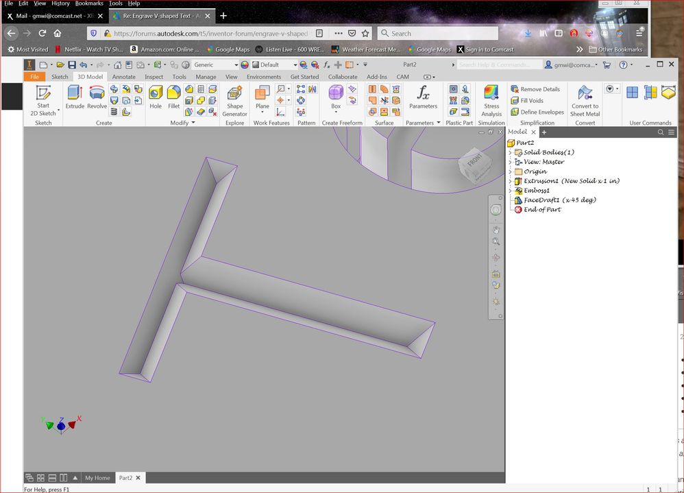

You emboss the letters and then daft the walls. Pay attention to which edge you select to pull because it is dependent.

The daft command is special, much like those people who are a bit daft.
I did a 45 degree draft on a text and if the auto-blend is on then it'll truncateText 45.JPG the depth. If you want the "as machined" with tapered tool look then yes, it's a difficult find. This approach might save you some time on modifying.
