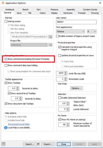

It appears that Dynamic input in my inventor 2017 software is not enabled. It is not visible when I draw a line etc. How can I confirm that it is enabled, and if it is disabled, how can I enable it?

Hi!
You can eneable it in the app options, general tab, prompting interaction section

johnsonshiue
Hi! I think you are looking for "Enable Heads-Up Display" option. Go to Tools -> Application Options -> Sketch.

I have enabled the radio button under Tools..Application Options..Head-up display, as well as both the radio buttons under heads up display settings for pointer input and dimension input where possible.  I still get no dynamic input displayed ...very frustrating is there anywhere else that this may be turned off somehow?
