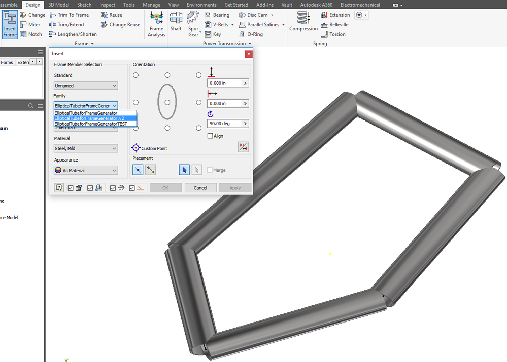

Hi all,
I have a part that I'm having trouble with, I authored it as a structural shape and published it into the content centre. It just happens to be an elliptical tube, so I sketched an ellipse and then offset it for the wall thickness and extruded it etc.
When I try to place it in an assembly it errors, but other parts I create work fine, it seems to be the ellipse that is causing the failure, I ended up resorting to drawing out an ellipse manually (Stretching the memory banks from tec drawing at school), and this works fine.
Attached are the two files the first with the non-working ellipse and the second .v2 version is the manually drawn ellipse.
I've potentially done something weird with the first version, but I can't figure it out.
There is a clue when you author the part as a structural shape the elliptical version doesn't have a preview in the selection window.
Inventor 2017.4.2

I went through and authored the ellipse shape by normal means just fine. It will select all the way through Frame Generator (though with no preview), go through frame naming, but errors at placement saying "could not be located in the Content Center library."
I authored v2 and it works no problem.
This might be a limitation with the ellipse as a profile method with Frame Generator. I'll keep looking around my end.
It appears you got it to work with the geometry drawn ellipse which is a bit of a headache but reasonable workaround for the repeat frame generator use.
Please select the Accept as Solution button if a post solves your issue or answers your question.

Yes, that's exactly the same as what I was seeing, I wanted to cross check things before I started asking if this is a limitation in the software or not. did you see when you click the 'Structural Shape' authoring button there is no preview at that early stage as well? Maybe that's a clue.
Ellipse in Sketch
Hand Drawn Ellipse
Thanks for taking a look.
