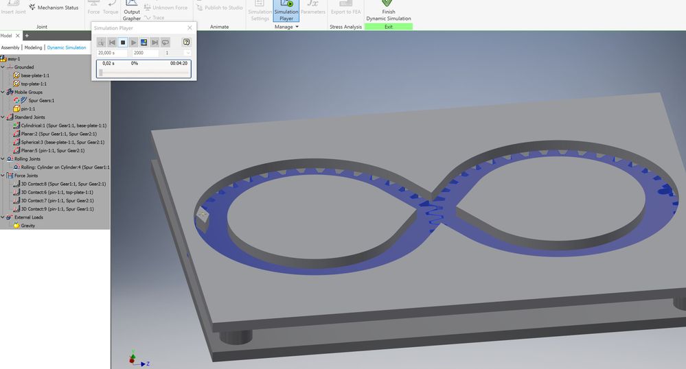

I would appreciate some help to get this simulation going, when I press start, nothing really happen, it goes too slow. Pics below if anyone can help. The slider/pin is supposed to move in the groove, riding on the gears.

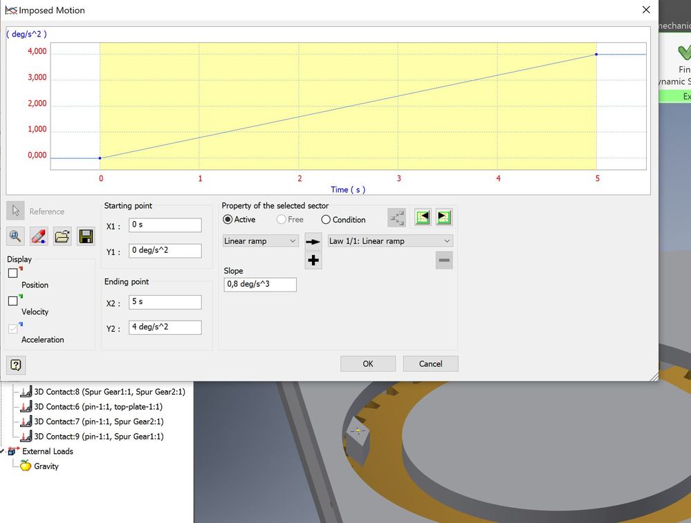

No this is a small hobby project of mine. I'm trying to insert 2D contact joints but there's always a problem with them, trying to read about them but the information is sparse, the video on Autodesk's homepage is using obsolete Flash player.
In the pic, what am I missing? The normal orientation is wrong accordingly to a dialog box that says the system is impossible to solve, or the curves intersect at multiple locations.
Note that I have updated my design a bit and changed joints as you suggested.

JDMather
in reply to: autoinv78
I do not see your new assembly here?

Thanks! I could not open the newer 2020 files on my Inventor. I did some improvements on my design yesterday and added 3D joints between the pin and all components it can come in contact with. With cylinder on cylinder joints between the gears. I did manage to simulate it, the question is if the simulation is working as it should, like is it reasonable that for the pin to move maybe 30 degrees on one gear, the simulation time is about 30min? I have done simulations in the past but always managed to use the other, faster, type of joints.
My computer is a core i9-9900K with 32GB Ram and RTX2060S.
In attached pic, I made some changes to the pin, making bottom part oval and added a round sweep around the upper part, my idea is that it should reduce contact surface between parts and thus speed up the simulation, but I don't know if this is case; guidance appreciated.

... and added 3D joints between the pin and all components it can come in contact with
3D joints need generally much more computing resources than 2D contact.
... to move maybe 30 degrees on one gear, the simulation time is about 30min
That seems so be too much. But without knowing your files (.ipt, .iam) I only can guess. A first idea: A simulation needs much time if you have overlapping parts (collisions) in the assembly already before starting the simulation. To check (and avoid) this do a collision analysis before starting the simulation. (My video in post #8 shows the creating a simulation in real time - in less than 40 sec the pin moved several times around. And my laptop has much less power than yours)

Thanks again for your reply.
I updated the pin and removed the "ovality" and the sweep. I attach the assembly and part files. When I run this in dynamic simulation, it takes 1 min to reach 0.01s in the simulation. I have checked for interference. I never get it to run smoothly with 3D joints which is why I have steered cleared from them in the past, must be doing something fundamentally wrong.

The main problem are (again) the 3D contact joints, as you can see in >>this video<<. Whenever possible you should avoid using this joints.
Even if I would define some joints other than you did (e.g. I would give all three gears a Revolution joint, but this has nothing to do with your current problem), in the video I show how you can use 2D contact joints instead of the 3D contacts.
As in your previous assembly again here a 2D contact between the pin and the top plate is not possible. But theoretical it must be possible. For now I do not want to analyze why this happens. Above I have shown that (after a new creating all the parts) also between the pin and the top plate a 2D contact IS possible.
