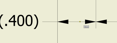

Any reason we don't have this "little yellow dot" so we can align angular dimensions to each other the way we do it for linear dimesions (screenshot below)?

I thought it's there.
Drag and touch the other dimension.  It should show.
mluterman
It only shows up for linear dimensions on mine, not angular.
Frederick_Law
Yes, it doesn't show.
It works this way:
Drag the dimension, not the line.
Drag it to touch the one you want to align.  It'll "snap"  and show dotted line.
It will be easier to select both and use Arrange Dimension:
